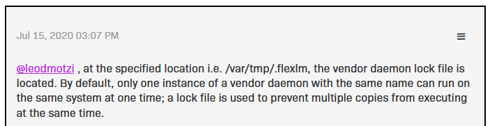

A quick Google search seems to indicate this is intentional.  Is there some reason you can't just combine the license files and then use the options file to control who is allowed to access each license (and how many)?
https://community.flexera.com/t5/FlexNet-Publisher-Forum/When-License-Manger-is-started-a-directory-var-tmp-flexlm-with/m-p/125047
