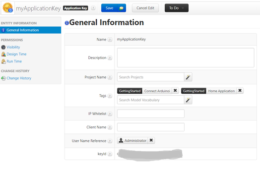

I have created a new Application Key in the thingworx composer and assigned it to user 'Administrator'

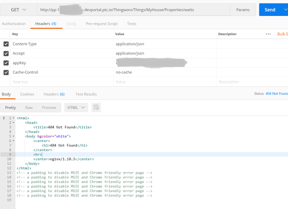

I have created a new Thing in the Composer itself. Now, I am trying to access the Things property using the REST API in postman.
I have tried sending the appKey parameter in URL. I have also tried sending appKey in Header. In both cases, I am getting a 404 not found error.
Can someone help me with the correct way to make rest api calls in Thingworx 8.

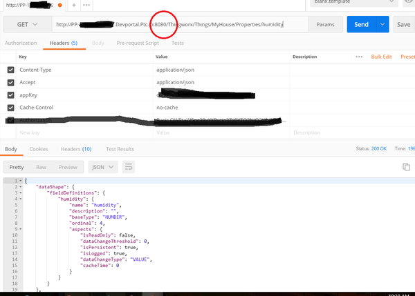

I have found the solution to the issue. To anyone who might be facing the same thing, this is what needs to be done. Adding the port 8080 to the URL is a must if you are using the 30 day trial hosted instance of the ThingWorx Foundation server.

This URL worked for me:
/Thingworx/Things/MyHouse/Properties/watts
Do you have a Thing named MyHouse with a Property named watts? Names are case sensitive.
Try setting a value for watts in composer to be sure everything is working.
Hi All,
