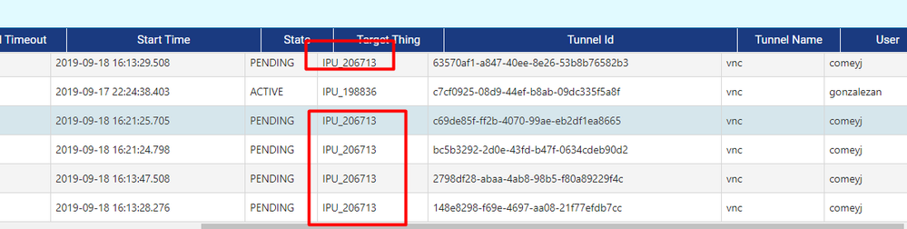

A lot of daemon tunnel sessions are created
htran-21
We are getting a lot of tickets related to Tunnel, A lot of daemon tunnel sessions are created and stay there for many days even that login users disconnected for a long time.
Any suggestions would be greatly appreciated!
My Bests,
Hung Tran
1 REPLY 1
PaiChung
22-Sapphire I
(To:htran-21)
I'm not certain why they don't terminate properly, you may have to put in a support ticket for that.
I do believe you can kill those with a service? There is "CancelTunnel" in the Tunnel subsystem
