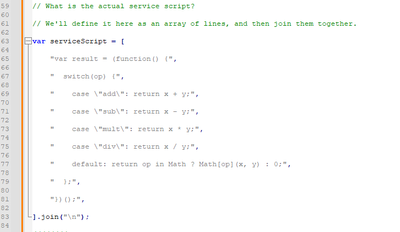

Hi @Hariharasuthan
This Community post has the answer to your question. Please look into this carefully and implement it in your case
Check Script Line Number: 60
PS: It is too challenging to write whole business logic for you so you have to create it on your own based on this reference

Hi @Hariharasuthan
