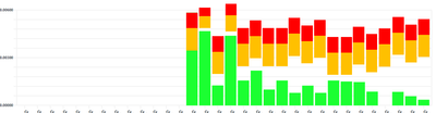

I would like to display barchart as attached. Where the green represents normal operation and yellow and red represents warning and alarm respectively.
when the green cross yellow\red area the bar should change the color respectively.
I used stack option with multiple source and adding state definition for color change, but it didn't look the same.
Any ideas to achieve the same.

Hi @sbt.
We're still not fully understanding your use case, but based on what we're seeing, it doesn't appear you can do this within the core product.  You would need to develop your own custom extension.

What version of ThingWorx are you running?  This video available in the ThingWorx 9 Help Center may be helpful.
If you're not able to resolve it, please provide specifics on what you're expecting to see in ThingWorx that you're not already seeing.

We are using Thingworx 9.1.5.

I'm afraid you'll need to provide further details of what it is you're seeing or not seeing.

Sorry the expectation was that for a bar the limit for warning lets say is 5 and limit for alarm is 10 and max y axis scale is 20. so from 5 to 10 it should show in yellow and 10 to rest in my case its 20max so until 20 in red.
if the value is 2 then the bar is green and if it breaches warning or alarm limit the bar has to turn the color accordingly.
I hope you got my point, but with the current bar chart i was not able to achieve the same.

Do you want the chart to look like the one in the screenshot you provided or is that a depiction of the problem?  You have breaks between the green and yellow bars, which doesn't appear to be what you would want.  Are state definitions working without the stacked option?  Why wouldn't you want the full bar to change colors depending on the value configured?

Yes @slangley  . We need exactly the same way what is shown in the screen shot. Also i really need to create white gap between the bars.
So the gap basically says that it will take x value to reach the warning limit.
Hope i gave you enough information.
