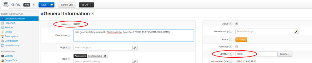

thanks for the quick reply. We do have a service looking for unbound things that runs on a timer event & all of that works fine. The question I'm trying to answer is what are the 2 parameters that have to match in order to make the remote thing binding work. Is it:
edge server auto_bind = server side thing name
or
edge server auto_bind = server side thing identifier
Currently the edge auto bind parameter has a prefix 'AB.xxxx' or 'CD.xxxx' depending on the remote thing's edge server. If we see an unbound thing with 'AB' as the prefix we use one template to create a thing, if we see 'CD' we use another. We set the identifier to be say 'AB.xxxx' but the server side thing name is 'xxxx'. I'd always assumed they bound using the identifier parameter.
I'm just trying to confirm  whether it is the server side name or identifier that is used to create the binding to the remote thing.
The reason I ask is that I see the server side things being created, and I can see that they are connected. The problem is none of the remotely bound properties are being updated. I wondered if this might be because the binding to the remote thing is not correct.

Currently we have:
Thingname != Remote Identifier
Haven't tried it the other way yet. I was hoping to avoid having server side thing names with the prefix included.
So are you saying that the server side thingname should match the remote identifier in order to get the remotely bound properties to bind automatically? (Not a massive issue if we have to).
Presumably I could create the remote bindings via a script [SetRemotePropertybinding()] if I want to keep the remote identifier & server side thing name as different values?

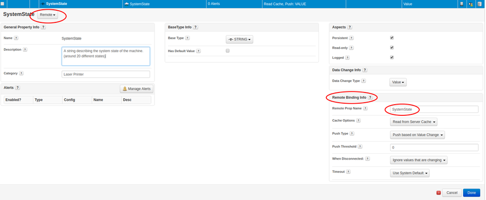

Sorry, forgot to mention that the properties in question are defined as being remotely bound at the template level.
In the past we have defined the bindings there and had no issue. That said the server side thing had the same value for both its thingname & its identifier.
