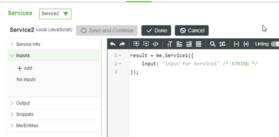

I'm creating multiple services in a Thing and i would like to know if it is possible to call function i've created in "Service1" in "Service2" ?
This to not rewrite the function again to have a proper code.

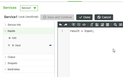

If I understand you correctly:
1. You have a Thing with two services, Service1 and Service2
2. To call Service1 from any other service of the same thing you can use the "me" like that.
result = me.Service1();
See the example attached.
Hope it helps.
