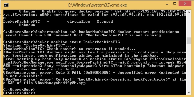

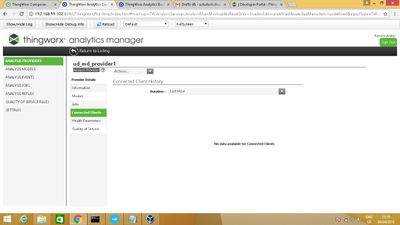

Hi @cmorfin,
So I've managed to setup ATE on a windows machine now but I'm still getting the same error when publishing a model. Everything else is working fine. Also the guide here says to look for some green square in Connected Clients. My connectedClient tab comes empty.TW_connclient_empty.jpg
The only thing that's slightly off is that when I do docker-machine ls, it says DockerMachinePTC is stopped and when I try to start it using docker-machine start, I gives following error:
I don't know what exactly is the problem with ThingPredictor here...
Plz help...
cmorfin
(To:ashu_shukla)
Hi
While investigating https://community.ptc.com/t5/ThingWorx-Developers/Model-deployment-failed-on-connector-TW-AnalysisServices/m-p/545857  I identified that the version of ATE downloaded is not the correct version that includes ThingPredictor configuration.
A new version should be uploaded soon.
However following the steps at https://www.ptc.com/en/support/article?n=CS284194 should allow to make it work with this current version.
Hope this helps
Regards
Christophe

This is the status of connectedClients in AnalyticsProvider details:
Also, the system-environment-variables.properties file already has the lines mentioned in this article so I guess ThingPredictor is there.
Can you guys help me with this error now

Hi @jwyatt and @cmorfin,
As you can see in the post above, I did try to restart ThingPredictor before publishing a model and as suggested by the logs, It looks like it was also started successfully. Also I can see the graph in connected clients also. All this suggest that ThingPredictor must work fine.
Have you seen the error that's been generated. Can someone figure out what that actually is?
