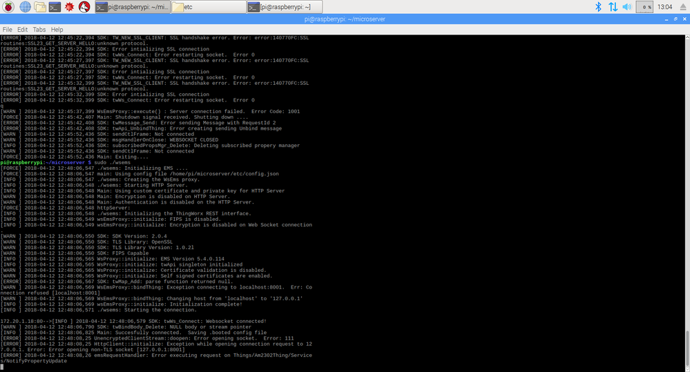

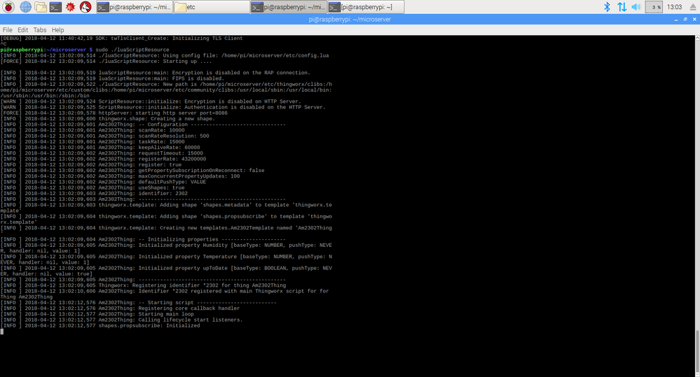

Hello Guys,
and thank in advance for your help.
I am trying  to connect a Raspberry Pi 3 to Thingworx using the EMS 5.4.
I am able to autobind in the config.json file but if im trying to bind it via LSR its not connecting.
Also the Properties dont get connected.

Hello.
This is a known issue with EMS 5.4 and a bug has been reported.
The suggested workarounds for the time being are to either enable SSL in EMS 5.4 using TLS encryption or to downgrade to EMS 5.3.4.
-- Craig A.

Hello Craig,
its now working because i am using the EMS 5.3.4.
but out of curiosity how should i configure my files to enable SSL, because i think i tried it too but it didn´t work.
Thanks for your Help
