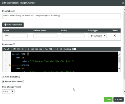

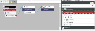

I want to change the sourceURL based on a thing property.
Currently I have an expression (see below) that has the input of a thing.getpropertyvalues and the output of a string connected to the media sourceURL property. Please see pictures below.
I have verified that the input property is accessible and changes (0 or 1).
Using: ThingWorx 8.4.2-b2151
switch (URL) {
case 1:
return "/Thingworx/MediaEntities/GridLeft";
break;
case 0:
return "/Thingworx/MediaEntities/GridRight";
break;
18-Opal
October 13, 2019
Try it like this:
switch (URL) {
 case 1:
 result = "/Thingworx/MediaEntities/GridLeft";
 break;
 case 0:
 result = "/Thingworx/MediaEntities/GridRight";
 break;
/ Constantine
