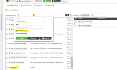

I have removed "Users" group from "ComposerUsers" group for testing. Now again I am not able to add "Users" group in ComposerUsers group. Now I am adding every user manually. What is the solution for this ?

@AP_9587236 When trying to add back the 'Users' group, check the Show system objects filter as per below snapshot. Then Users group would be visible and can be added back.
