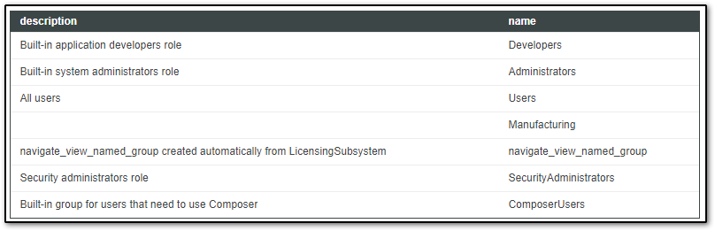

Create a service where you can call
var result = Resources["CurrentSessionInfo"].GetCurrentUserGroups();
It returns an infotable :

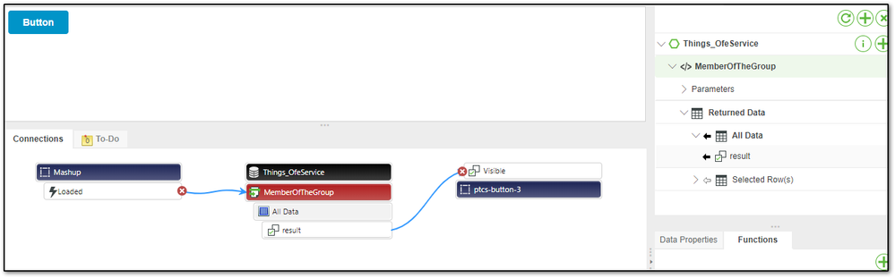

Next, some bindings :
And it works
And it works
