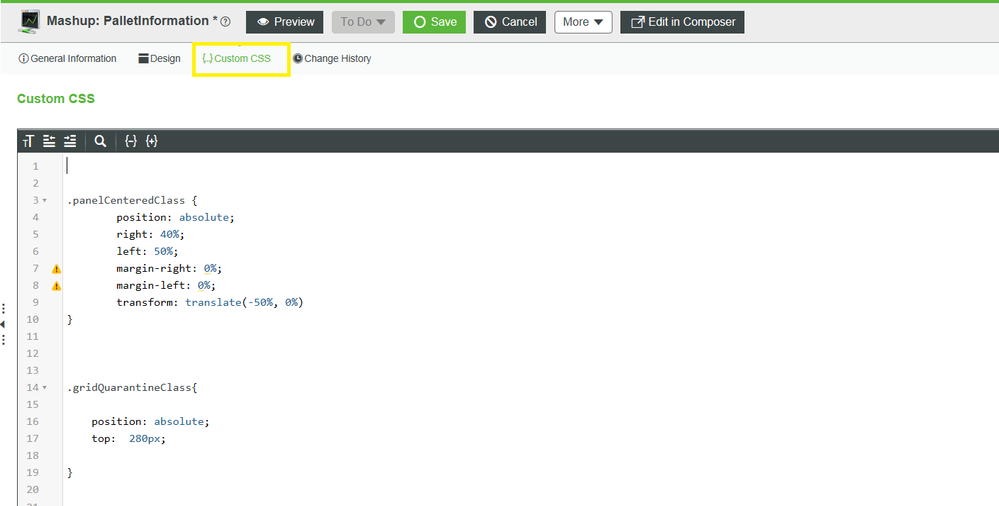

But this does not work because I cannot see a "CustomCSS" tab. I want to write a small css code just to rotate the mashup 90 deg. Code should be = transform: {rotate(90deg);} but I donot know where to write it in the composer.

Adding custom CSS to mashups was introduced in ThingWorx 8.2. You will find the Custom CSS tab when you open the mashup in the New Composer.
Refer this article to enable New Composer -
https://www.ptc.com/en/support/article?n=CS282951&language=en&posno=3&q=new%20composer&source=search
