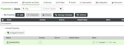

I am trying to call Windchill custom url https://hostname/Windchill/servlet/custom/path
From Browser where SSO works it returns string value
However when I created Swagger connector with Configured SSO on Thingworx it returns
something like this
ContentLoaderFunctions.GetText - works with basic Authentication but I need SSO
Any ides?

I created Swagger Connector
SwaggerJSON value:
    "cosumes": [
        "text/html"
    "basePath": "/Windchill",
    "paths": {
        "/servlet/custom/getNumber": {
            "get": {
                "summary": "Get Parts of type Product",
                "responses": {
                    "200": {
                        "schema": {
                            "type": "string"
                        "description": "Successful operation"
                    "400": {
                        "schema": {
                            "type": "string"
                    "404": {
                        "schema": {
                            "type": "string"
                    "406": {
                        "schema": {
                            "type": "string"
                "description": "Get Number of type Product",
                "operationId": "Get_Number_of_type_Product",
                "parameters": [
                        "in": "query",
                        "uniqueItems": true,
                        "name": "numberRange",
                        "description": "",
                        "type": "string",
                        "required": false
                "tags": [
                    "CustomEndPoint"
    "host": "hostname",
    "produces": [
        "text/plain"
    "schemes": [
        "https"
    "definitions": {},
    "swagger": "2.0",
    "info": {
        "description": "Retrieves Windchill Custom endpoints",
        "title": "Windchill Custom Endpoints",
        "version": "1.0.0"
    "tags": [
            "name": "CustomEndPoint"
Service created for Route from JSON
returns:
Return Value should be String
RadekIOT
