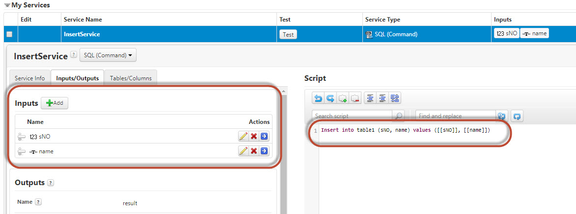

Hi @Gucio if you are looking to run Insert statements from ThingWorx SQL Service, you could create an SQLCommand service with Insert statement and then call this under a wrapper service something like
1. Create SQL  Insert  Service
Insert into table1 (sNO, name) values ([[sNO]], [[name]])
here's how it'd look in the Service section, with two inputs :

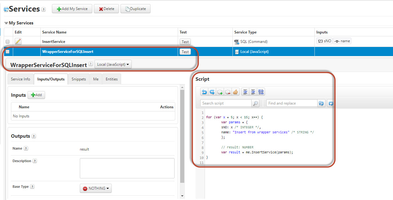

2. Wrapping  my SQL Command service
for (var x = 5; x < 15; x++) {
        var params = {
        sNO: x /* INTEGER */,
        name: "Insert from wrapper services" /* STRING */
        // result: NUMBER
        var result = me.InsertService(params);
