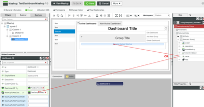

I tried to make the following training:https://developer.thingworx.com/en/resources/guides/customizable-responsive-ui/ui-completed-samples
But the dashboard is not working. On the left side I have a list, when I select an element of the list the content of the dashboard should be actualized. This is not happening. According to me it seems that the property worldName of the gadget is never bind to a value, but I don't know how to do this. Do you have an idea how to do that?

Hi PaiChung, thank you very much for your Answer, but I'm not sure I understand it. In the training Step 4.12 the data (ThingTemplates_HeloWorldTemplate.GetImplementedThings.allData) are bind to the list widget - There is no binding with the selected row. I bind the selected row now (ThingTemplates_HelloWorldTemplate.GetImplementedThings.SelectedRow.name) to the parameter of the service used by the Gadget (DynamicThingTemplates_HelloWorldTemplate.GetPropertyValues.EntityName) But it still doesn't work, what is missing?
In the Step 2.7 a new mashup parameter 'worldName' is created and then bind to the parameter of the service used by the Gadget (DynamicThingTemplates_HelloWorldTemplate.GetPropertyValues.EntityName). I'm don't know why then it's not used after that

Sep 24, 2019 1:32 PM UTC
Looks like the guide is missing a step or two.
1, If you look at the sample, theTestGadgetLibrary1 has a WorldName Mashup parameter. InTestDashboardMashup1, drag and drop your 'Selected Row' from the 'GetImplementedThings' service (used on the list) to the Dashboard. It might prompt you to confirm the gadget library TestGadgetLibrary1, confirm.
2. In TestGadgetLibrary1, ensure you have a connection from the Mashup parameter 'WorldName' to each gadget.
PaiChung22-Sapphire IAnswer

Sorry, you are using an actual Thingworx Dashboard and Gadget setup.
The only way then to propagate the selection is by using a Session Parameter.
So set the Selected Row worldName to a Session parameter you create,
and then use that session parameter to bind to the service within your gadgets.
