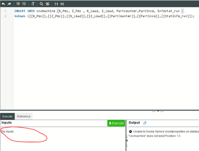

Sure thing. I have data streaming in from a machine into Thingworx, but now I wanted to store this data into an external database. I want to insert the data points im getting from the machines into the postgreSQL.  Currently I have values streaming into Thingworx already.
@Malcolmlsh, so what schema do you have in that external database? I.e. what tables do you have, what columns, their data types, etc.? Based on this you would write your SQL statements to insert / select / delete / update data there.
/ Constantine
I have this in the external database that I manually keyed in. I don’t know what’s wrong.

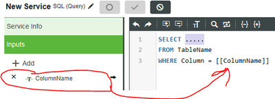

@Malcolmlsh
1- Check whether cncmachine table created in your external database or not
2- There are no inputs in the service that you have created. You need to add inputs of all the parameters that you have written in Values().
here it is, sorry i didn't attach it in the previous reply

Who has created that table and how it has been created?
Malcolmlsh
6-Contributor
(To:mnaeem)
Done. Still says 'sevenonetwo' does not exist.
