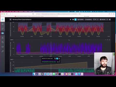

Hello @ST_10591134
That article you referenced says "the Subscriptions still could get the ordered DataChange event and be triggered after Connection is restored"...  this might happen effectively, but what would be more correct to say is that order may or may not be maintained.  The reason for this is that Kepware has been built with data transmission performance in mind, and that this sacrifices ensuring order.
To achieve what you're trying to do, you actually need to subscribe to both the DataChange and HistoricalDataLogged events.  I made a video explaining this here.
You can also use the Utilization Subsystem statistics to count the Subscriptions fired and Service executions which would call your code to inject to the database.
As for "what's the best way to do this without using Value Streams" question, I'd suggest using Value Streams, as that ingestion pipeline is very well rounded and will be far more reliable and performant than something that you'd likely spend the time to build.  However if I were going to set out to do this, I'd probably look have an InfoTable that would catch the updates in memory and then do batched writes every few hundred entries.  Note that such an approach would have a memory impact, as well as any Ignite cache synchronisation, however doing inserts value by value will be incredibly inefficient on the DB side.
