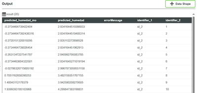

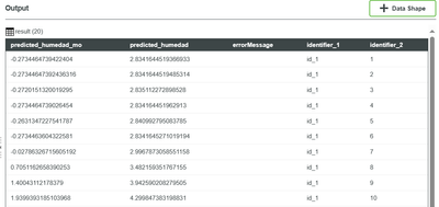

Hi @Rocko thanks for your answer. I just tried a couple of things. The entity id must be present and unique for every run if there are gaps in time. If I set a constant entity id it fails to train warning that the time sampling is not consistent with what was configured in the dataset import.
"there should be no difference in which Entity ID you pass in for scoring" I would think so too, but confirmation would be great. You also say it'd be quick to try, how do you suggest I go about that? I could score trying different entity ids for the same data and model, but how will I know if it makes a difference or not? I'm must be missing something.
Well maybe I'm missing something I would've tried to score the same sample data with two different entity ids and see if there is a difference in the goal value. If not, the entity_id didn't make a difference.
precisionlabs
6-Contributor
(To:Rocko)
Came back here to report exactly that. I tried to score the same data with 2 different entity ids and it gives me the exact same results (actually the entity id passed for scoring doesn't even need to be one from the training dataset, it could be anything, but needs to be present in the scoring dataset). It just uses the scoring entity id as an identifier in the prediction results. Screenshots of both tests attached.
"You trained one model which should be valid for all the machines/series, not one model per machine/series, all packed into one." This was the key insight and after testing I can confirm that's accurate, thank you @Rocko.
