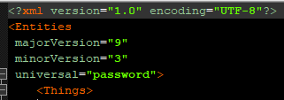

Hello Communtiy,
For some time now I have been using the "Export as Source Control Entities" function and SourceTree when I want to save something in our internal source control system.
However some of my colleagues use the PTC(?) built Git Mashup for the same functionality.
What I have noticed is that when someone has used the Git Mashup for source control, the XML contains a "password" in the <Entities> universal tag.
But when I have exported it using the Source Control Entities function the <Entities> universal tag is empty.
This causes some quite annoying issues when trying to actually see what has been changed between commits as every single entity now looks changed.
Does anyone have any ideas on what causes this?
I suppose as a workaround I could add the "password" value in the tags manually. But if possible I would rather not.

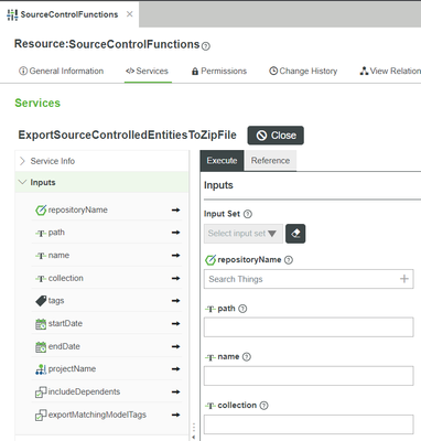

We think we have narrowed it down to some bug in the export and zip functionality of Thingworx:

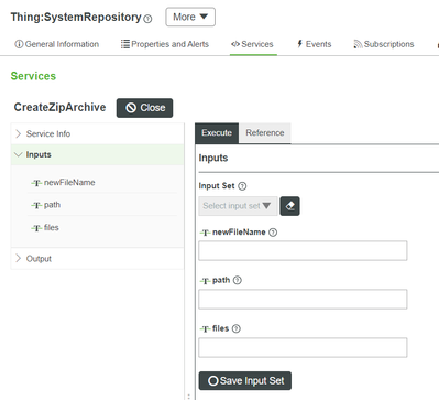

What we found is that the following service also has the exact same issue (so perhaps same code is used for the export to zip file in the export function).
For now, the workaround will be to first export the project to a repository and from there zip it manually using the CreateZipArchive on any repository:
And then downloading the zipped file manually.

VladimirRosu
(To:jensc)
Thanks! I guess I did not pay attention to the name of the Service you called, specifically the "ToZipFile". I tested this and I confirm I see this issue also in 9.3.8
