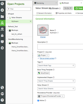

Hi @SachinSharma
I went as per you suggestion followed the below steps -
1. Created VS (My Stream) with persistence provider defined in the body
2. Enabled the thing
3. Restarted the thing
All the above step were done with Postman.
As per your input I checked todo list there was nothing there (See below screen shot)
While trying to delete this thing I got an error. I am attaching logs for your reference.
Hope this helps. Thanks in advance.
