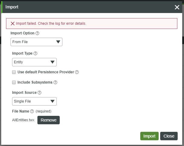

I'm beginner in the thingworx and I have difficult to import entity and data.
I have a backup from other account that I would like to import to my new foundation account. So whem I to have tried to import it happens the error in the image below:

According to the log, you are missing an extension related to AWS in the new Thingworx instance where you want to import.
First, import the extension and after try again to import (I advise you to enable "Use Default persistence provider" when you will do again the import).

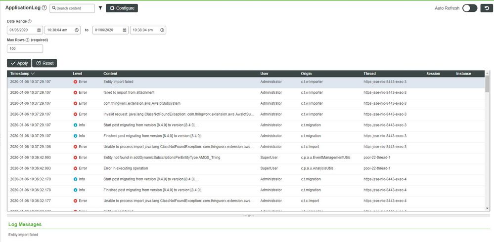

To check the logs, you need to select "Monitoring" on the leftmost tab, and then "Application Log". Do this after you try an import, and check the error. What does it say then?

Below the image of log after I try to import:
