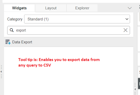

Hi @RK_0705 ,
Have you tried using Data Export widget? It exports data into CSV (use excel to read it).
