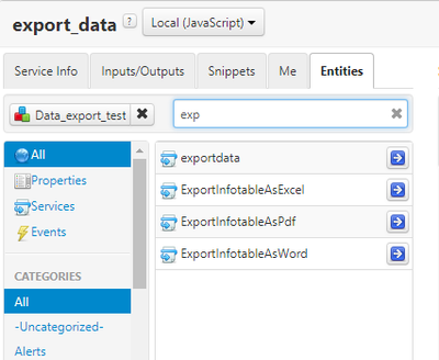

But the issue that I had was I already had an existing thing that I wanted to export data for.
I thought that I could just use service from the DataExporter, but for some reason they are not there? (am i doing something wrong?)
As a last resort i created an additional thing to see if I could pull the services from that one.
and I could.
So now my code looks like this.
var params = {
	oldestFirst: undefined /* BOOLEAN */,
	maxItems: 10 /* NUMBER */,
	endDate: undefined /* DATETIME */,
	query: undefined /* QUERY */,
	startDate: undefined /* DATETIME */
// result: INFOTABLE dataShape: "undefined"
var result1 = me.QueryPropertyHistory(params);
var params = {
    infotable: result1
// result: STRING
var result = Things["Data_export_test"].ExportInfotableAsExcel(params);
Its a simple example but it now works.
if you see where i went wrong please direct me to the correct solution.
