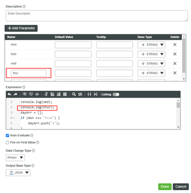

It seems that the expression can only accept 3 parameters,  the 4th and consequent parameters are not recognized.
In the attached screenshot,  console.log(thur) print nothing whatever the base type is STRING or BOOLEAN.
And the 4th parameter has a strange border .

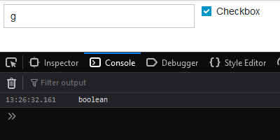

On the boolean side I could not reproduce though. When a Checkbox's state is bound to a boolean type input parameter, the typeof returns boolean - as seen in the console below.

I tried adding 4 parameters to expression and print the values over console and was able to do so.
Might be you are missing something . Can you provide more detail of your use case?

I tried again today and yes, console.log  the 4th parameter works, I have no idea why it didn't work.
But it still has some problem for data type "BOOLEAN" ,  the passed value is STRING "true" instead of true for the 4th parameter although set the data type to BOOLEAN.   Set the data type to "STRING" can be a workaround .
