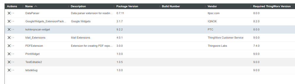

@KN_9954684 I'm able to import your extension in Thingworx 9.2.0
Try to import your extension into a different environment and check

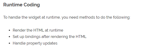

Hi @KN_9954684
Based on your error message, some required methods are missing in your runtime.js
Please refer to this link for the complete extension development guide - Create A Mashup Widget Extension Part 1 - PTC Community
/VR

Thanks for the reply.
As I see,In the link you mentioned it describes older way of developing widget extenisons.After importing it, we cannot see style themes and style props as per Thingworx latest versions.
I am following below link to develop widgets currently.Can you help me with latest widget example by inhereting web components.
https://support.ptc.com/help/thingworx_hc/visual_sdk/

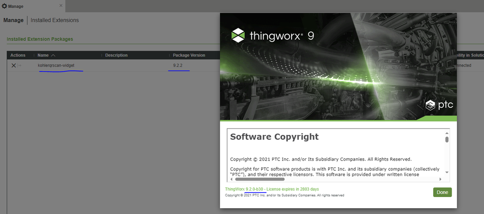

Hi @KN_9954684
Thanks for letting me know.
May I know your Thingworx Version.
I tried importing your extension into Thingworx 9.3.7 and it got imported without any error
/VR

Thingworx 9.2.1
