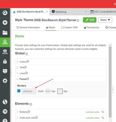

Facing issue in removing border in checkbox widget
  • November 21, 2023

Facing issue in removing border in checkbox widget in thingworx 9.4

Hi @AC_10460579 ,
Either you must be using OOTB style theme or there must be a custom one. Go to the Style Theme that is being used in your application and do the below highlighted changes.
Shirish

@AC_10460579 ,
I asked one of the experts and I got a solution which should work for ThingWorx 9.4.0.
ptcs-checkbox {
  --ptcs-focus-overlay--border-style: none;
Please give this a try in the Custome CSS tab. You will need to disable the "linting" in the editor to save the update.
Let me know how it works for you.
Pehowe

March 14, 2025
Hello @AC_10460579
With the change in version there has been updates to the UI.
One of the changes was the addition of a new control for the definition of the Mashup. Please review the properties on the mashup. Look for the LegacyFocus. (See screen Capture)
If this property is unchecked. the original CSS should work.
ptcs-checkbox {
Please let me know
