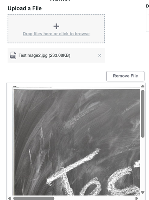

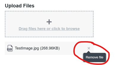

When I upload a file, it shows the file below with an "x" to remove the file as well. However, I need to remove this "x" because there is no bindable event to removing an item. Instead, I have a button to clear the items which then triggers some other services.
How do I remove the "x" button from this widget as shown below? Thingworx 9.6
Rocko
(To:JO_9930585)
add custom css to the mashup:
@supports (ptcs-style-unit: "PTCS-FILE-UPLOAD-LIST-ITEM") {
[part=hit-area] {
display:none;
you probably need to disable linting which will keep you from saving.

The x removes the file from the list of files to be uploaded, in case you accidentally added something to the list. It does not need to be bound to work.

As Rocko, indicated the "X" is used to update the file which is selected for Upload.  It is has no other action then to remove the selected file name from the widget.
In your post you indicate that you have a button which does this action. What other operations are required for removing the file selected in the widget.

When a user clicks the "x" it removes the file from the list as stated. I have a webframe directly below this that shows the file that has been selected. The "x" does NOT have a bindable event to clear this webframe when it is clicked. Therefore, I am using a button to clear the file. However, the "x" is still visible which is not desirable since it is not useable. Also, the file upload widget is disabled after a single file is uploaded which gives the "x" button no functionality. This is great, but it is still visible.
[part=hit-area] {
display:none;
JO_9930585
(To:Rocko)
Thanks! This is what I was looking for.
