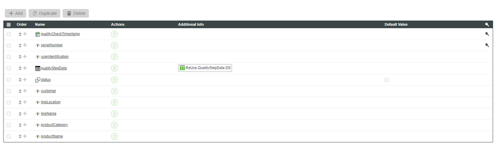

So first of all in my datatable i have entries and the datashape for each entry is as below:
qualityCheckTimestamp [DateTime]
serialNumber [DateTime]
MaterialNumber [String]
userIdentification  [String]
SData  [InfoTable]
status [Boolean]
ProDate [DateTime]
affix [String]
qualityCheckTimestamp and serialNumber are my primarykeys

This is below the fields of my Datashape which does not include (key, location, source, sourceType, tags and timestamp) and i am adding serialNumber in service FindDataTableEntries to find the entry but it is not working. It returns no data. Please help me in this regard
Do any of those fields have default values defined? If so, FindDataTableEntries does not work and you will have to use QueryDataTableEntries with a query parameter (or remove the default value definitions)).

@Rocko  I have uploaded a full picture now. Please have a look there is no default values for these fields.

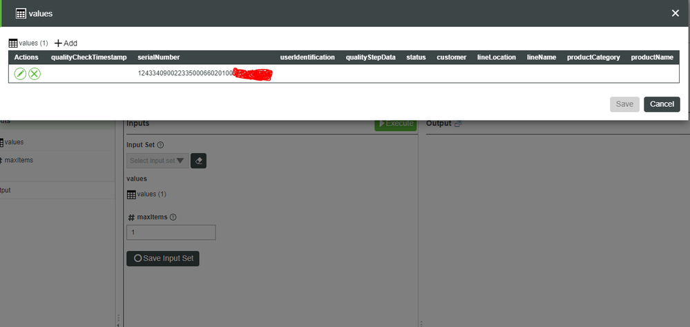

look thats how i am using findDatatableentries. i am just giving the serialNumber of the entry and it returns me no data. I even have set an index in configuration of the datatable then i executed the service reindex also and restart thing also. but no it is not returning the entry with this serialnumber.
Ok, just to be sure also check that the embedded qualityCheck DS does not have a default value defined. Not sure what is happening here, but I wonder if you can/should have empty key fields. You defined the key to have two columns, serialNo and qualityCheckTimestamp, but qualityCheckTimestamp is empty. This could be issue. If you can't make it work, just use QueryDataTableEntries.

I have tried to use another field (other then primary key) to find the entry but it is still not working and there is no default value for the embedded qualitycheck datashape. I want to use this service because it is fast to find an entry with it as it uses an index to find the entry but it does not work. i have no idea that why it is not working. QueryDataTableEntries service is slow because it does not use index so it searches for all the field in an entry.

To rule out you're calling FindDataTableEntries with spaces in the string argument I recommend writing a service that calls FindDataTableEntries instead of calling the service interactively.

MA8731174
(To:Rocko)
Thanks for info. Its working,. I have written a service and use it there and not trying directly from the datatable thing. Now the question is it is not fast as compared to QueryDataTableEntry. Its almost same performance. I thought it would be fast but i have not seen a major difference. any idea?
Hard to say without seeing what you did in the service. Datatables in general are not particularly fast, as all row data go into one JSON column in the DB. So filtering is done no application side, not DB side.
