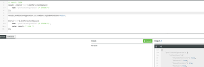

you can get current configuration via
// result: JSON
result = Users["Test"].GetPersistentValue({
	name: "profileConfiguration" /* STRING */
and set it back via SetPersistentValue

I tried to run the service on several users, but it always returns empty.
That indicates that the service does exist but does not return any valid JSON result. Maybe there was a change with ThingWorx 10.0.0.
I checked in PostgreSQL and didn't find any kind of profile configuration in the user tables.
I'll continue to check where this will be stored - because, in the end, I think users should not have ALL rights and permissions by default. It needs to be an additive model instead of a subtractive one.
You are (somewhat) right, interesting.
If I did not save the profile configuration in composer for the user first, I do get empty result.
If I saved it once I do get the result.
It seems that it does not return the "default" settings. But for sure you could write the settings to it.
So the services work as desribed before but you need to handle the case where it was not yet changed. (also works in twx 10)
D'oh .... I have tried to save and save and save the Profile without anything ever returned in the service.
It seems like you need to do at least one change to persist it, otherwise it defaults to all=true. If there was no change, it never persists.
After this, I am then able to actually get a result.
I'm using this now to block all menu-items except for "Modelling > Things".
This will then just be an additional measure, but should be covered by removing access to the Composer completely.
But the service returns something useful now
Thanks for pointing this out!
