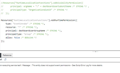

Currently I  am  trying to add runtime permissions for PlatformSubsystem , CurrentSessionInfo & RuntimeLocalizationFunctions through service. I am only able to add permissions for  "ServiceInvoke" but if I try to add permissions for  "PropertyRead" , "PropertyWrite", "EventInvoke" , "EventSubscribe"
I am getting error message for event perms.  = > Error executing service test1. Message :: This entity does not support event permissions - See Script Error Log for more details.
 for property perms. = > Error executing service test1. Message :: This entity does not support property permissions - See Script Error Log for more details.

var json = Resources["RuntimeLocalizationFunctions"].GetRunTimePermissionsAsJSON();
json["permissions"].push({
"PropertyRead": [{
"isPermitted": true,
"name": dashboardUserGroupName, //usergroup
"type": "Group"
"resourceName": "*"
"PropertyWrite": [{
"type": "Group"
"resourceName": "*"
"ServiceInvoke": [{
"type": "Group"
"resourceName": "*"
"EventInvoke": [{
"isPermitted": false,
"type": "Group"
"resourceName": "*"
"EventSubscribe": [{
"type": "Group"
"resourceName": "*"
result = Resources["RuntimeLocalizationFunctions"].SetRunTimePermissionsAsJSON({
 permissions: json /* JSON */
Hope, this will be helpful for someone, sometime 🙂

Hi @sabharees,
The error is because you set the type as "EventInvoke",  we can not define events in PlatformSubsystem or RuntimeLocalizationFunctions resource, so there isn't the type as EventInvoke when executing AddRunTimePermission on the two resources.
/Yoyo
