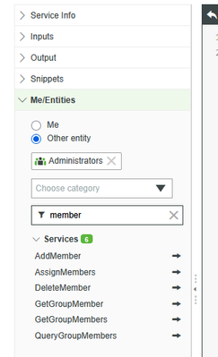

Thank you! do you also have any clue that if there exists also a function with which we can remove all the users which one group has in it?
I am not aware of such a service. Only deleting members one by one via the DeleteMember service
would you please share a link or how can i see all these services in thingworx? or any resource if you have ?
sure: In script editor either with autocomplete or with the "Me/Entities" feature:
Or via via REST API e.g. <yourhost>/Thingworx/Groups/Administrators/ServiceDefinitions
For Things its easier as you can see the services in Composer directly.
