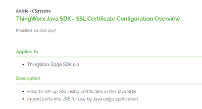

Hello @htran-21 ,
pls check the following article to set up cert for CCO.
https://www.ptc.com/en/support/article/cs272670
Let me know if that helps.
Regards
Bhawna

Hi Bhawna,
I visited the link but that does not provide any details.
Hung Tran

(To:htran-21)
You can find a detailed solution in the attached PDF file.
