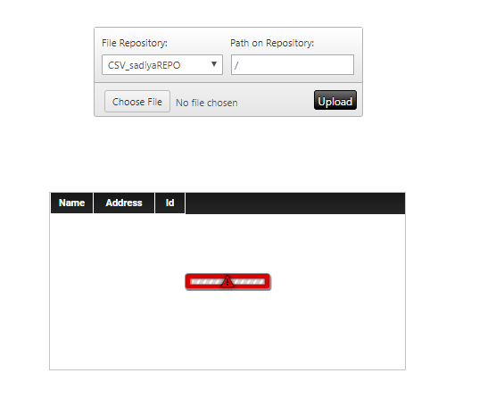

i have used a file upload widget and upload a .csv file but i'm unable to display the data in a grid.
unable to write the exact service.
