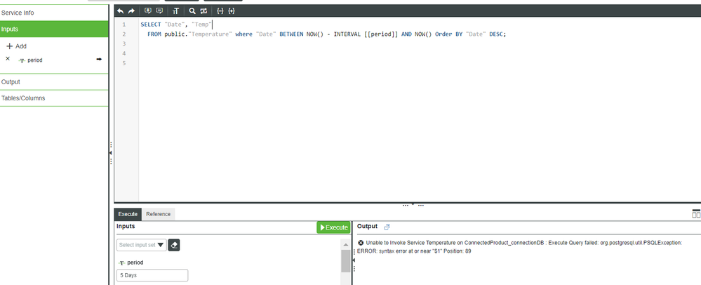

I have one service which has one input as period I put days value it give error but when put it hardcode values then it works fineCapture.PNG
Try this:
select "Date","Temp"
from public."Temperature" where "Date" between (now()-[[period]]::interval) and now();
On my end is working fine.
Hope it helps,
Raluca Edu

Thank you so much It's working
