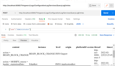

Mukul
(To:AP_9587236)
I am testing this on Thingworx 9.2.3 only. Here is my call snapshot from Postman including the result.
