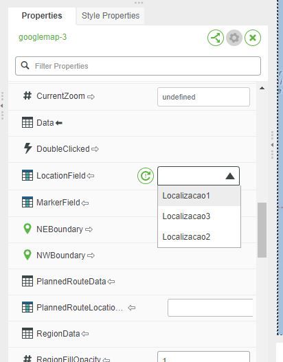

How many rows of data you mapped with map widget?
If multiple rows of data available it will show multiple marker. Or you can use state formatting option in map widget properties to enable multiple icons based on any field.
Sathishkumar C.
I have three rows of data that I'd like to show in my map.
Image below:
But I don't know how can I to bind these three data in the property "LocationField"
