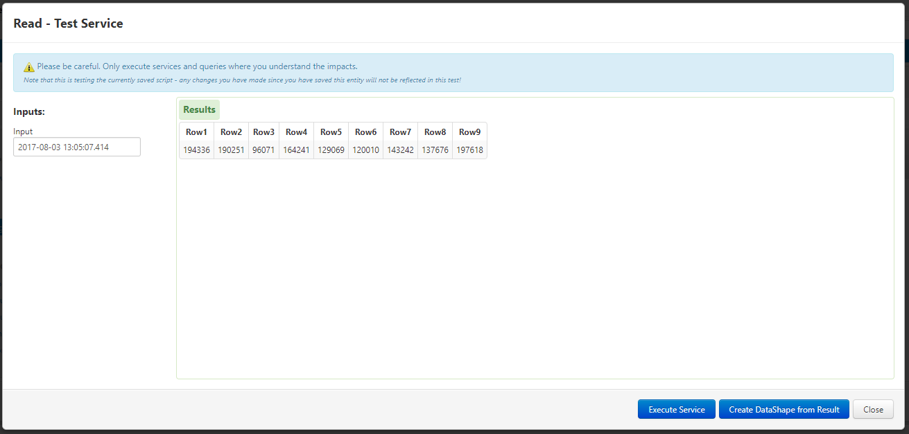

Nuttapol, are you looking for something like this
Here SpeedDTDemo is my dataTable on which i am doing single entry insert using the AddDataTableEntry service
var values = Things["SpeedDTDemo"].CreateValues();
values.SpeedVal = inputVal; //NUMBER [Primary Key]
var params = {
sourceType: undefined /* STRING */,
values: values /* INFOTABLE*/,
location: undefined /* LOCATION */,
source: undefined /* STRING */,
tags: undefined /* TAGS */
// result: STRING
var id = Things["SpeedDTDemo"].AddDataTableEntry(params);
If you are simply testing the service you will not see all the data that has been inserted previous to that particular call, for that you either need to navigate to your Datatable > HomeMashup, like i have shown below in the screenshot, or else you have to query your datatable to see the values that has been inserted so far
Hope this helps.
