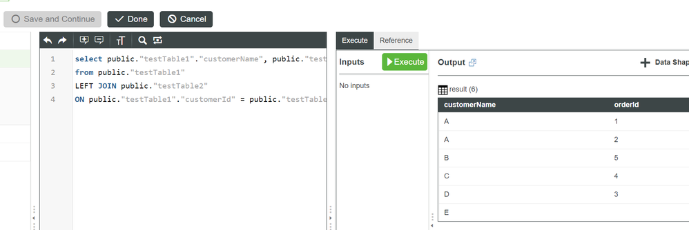

Velkumar
(To:PK_11081141)
Hi @PK_11081141
I tried below Query with PostgreSQL Connection and it is working fine
select public."testTable1"."customerName", public."testTable2"."orderId" from public."testTable1"
LEFT JOIN public."testTable2" ON public."testTable1"."customerId" = public."testTable2"."customerId"
ORDER BY public."testTable1"."customerName";
Could you please post your query here. Also, error message while executing query.
/VR
