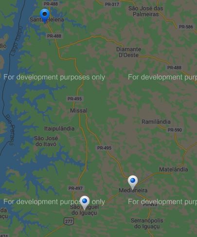

I have created some markers on google map and I'd like to navigate to another mashup when I click on marker.
