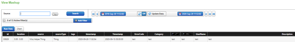

September 30, 2020
@Willie
I have observed this behavior earlier, I have handled it by using source field. While inserting the rows to stream, i have set source as actual source concatenate  with GUID. As source is primary key if the source changes it will write it to stream without any issues. It will allow duplicate timestamp as source changes.
Tags which i mentioned earlier is indexed column but not primary key.
Willie16-PearlAuthor
September 30, 2020
@abhiramk
Does this mean it will allow duplicate timestamps since tags is also a primary key?
