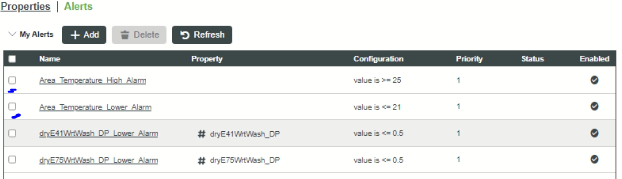

Hi ,
I found some Remote bound Things having alerts without properties in 8.4 version of thingworx.
The Alerts were created and then someone deleted its  property. And now that alert is not getting deleted.
This ghost Alert is not allowing us to migrate this entity from one platform to another.
Is there any method or workaround to delete this Alert ?

Hi Jens,
They are visible in composer. I tried to select them and delete, but its not working.
Will removing from XML work in this case?
Are there any workarounds where we can go and delete some entries in the database?

Hi Jens,
I tried another method and the issue got resolved!.
I didn't edit the xml file. But I got the name of the deleted property for that alert.
Then in the composer, I added that deleted property newly in that thing and saved it.
That ghost alert automatically got deleted !
