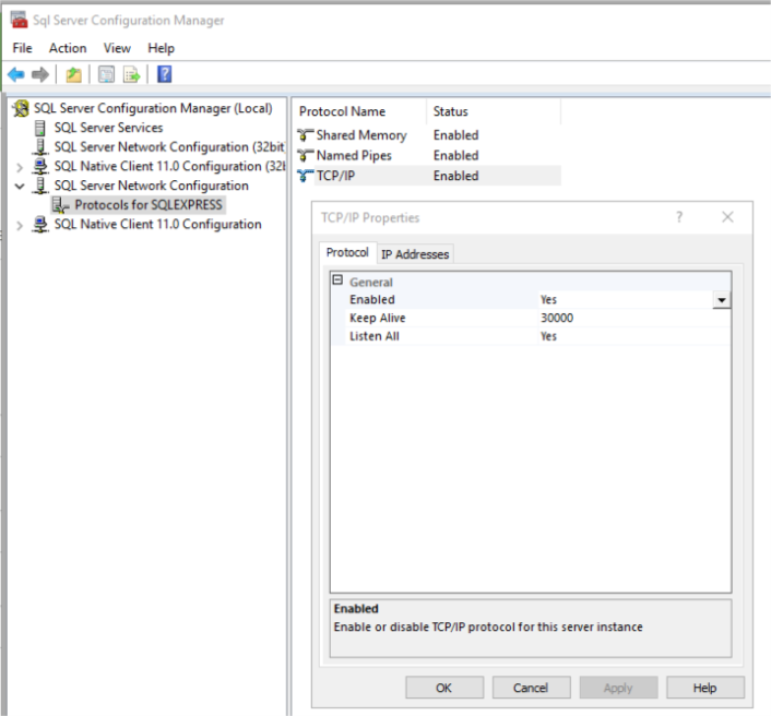

Please, suggest me. How to config below list.
JDBC Driver Class Name
JDBC Connection String
connectionValidationStiring
I using MSSQL Express, user is "sa" ( This user can login already and password correct )

Can't
Now It's now working
Can you remote for me?
