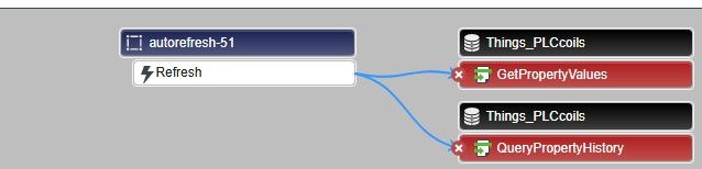

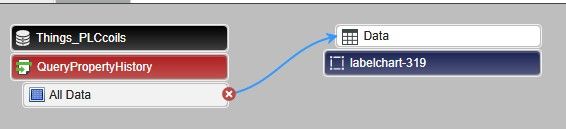

I added a current speed property and Valuestream to my Thing.Then I added the QueryPropertyHistory service to my Mash up.
I bind the data to my label chart.
But I found that my label chart will refresh and update the data every ten seconds. I set it to refresh every 0.3 seconds in the autorefresh widget.

My suspect is refresh every 0.3 seconds is working, it's just the new data is not pushed to ThingWorx at such a frequent rate (data probably pushed from edge device every 10 seconds).
That why even it's refreshed there's no new data to be fetched or updated.
To verify if the RefreshInterval setting is kicking in,
you can open up browser developer tool by pressing F12 function key,
navigate to Network tab to inspect whether the GetPropertyValues and QueryPropertyHistory services of PLCcoils Thing are executed at 0.3s interval.
