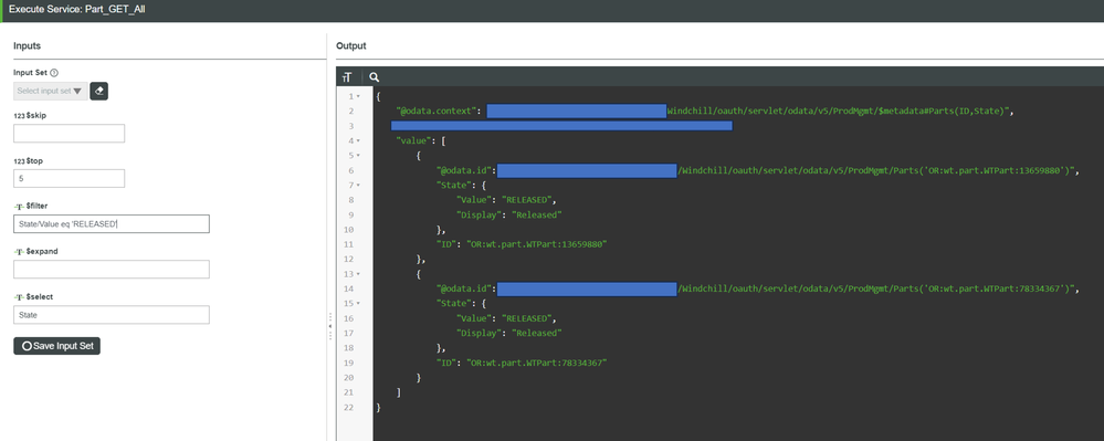

I don't have much idea about NavigateSearchThing. You can also use WindchillODataConnector directly to fetch parts details from Windchill
Could you please provide a sample response from Windchill without any filter
