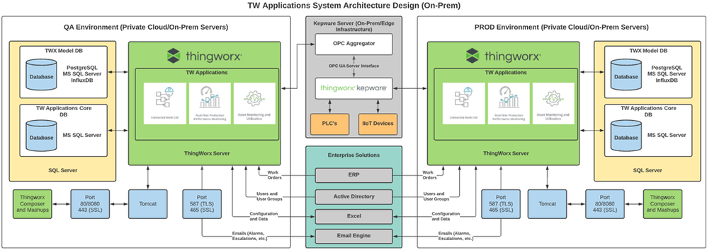

Are there any best practices regarding installing RTPPM w/ MS SQL on an existing ThingWorx running w/ PostgreSQL?

There shouldn't be anything necessarily different or special to install RTPPM onto an existing ThingWorx deployment.
Please do make sure your versions match etc. as described in the RTPPM install instructions.

Thank you this helps a lot. Especially this picture explains it:
SitePrep_Sys_Arch_Design
