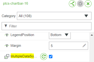

Hi @krishnakomal123 You need to check the field MultipleDataSources property of your Chart Widget and then you will be able to define more than one x-axis fields.
After using Multiple datasources, the chart got divided into two charts and showing like below which is not as per chart image I shared above
Please let me know how to acheive the same
