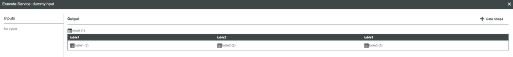

I have a collections of infotable as shown below. Each table has different column structure and no tables are same. Now I need to iterate through each infotable and export the data as a excel report.
using the snippet.

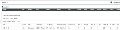

Sorry for the delay in reply, Your code works fine and combined all the info table as expected in the console.

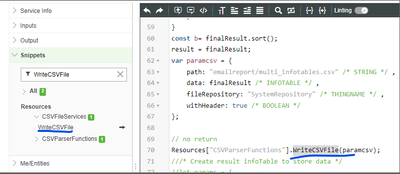

But when I tried to write the result in a CSV file as output the column (field name) order shuffled and the CSV output is different from the console output.
Is there any correction needed in the Script? Please assist. Thank you

Sorting of column names in CSV should be handled in CSVParser Extension / Service.
We don't have much control over it.
May I know which service/extension you are using to export the CSV file or is this an OOTB data exporter widget?
You can also build your own Excel Export extension using Apache POI to get the desired output format.
/VR

We are using ThingWorx Snippet to write the result as a CSV.
Velkumar
(To:SKannapiran)
Hi @SKannapiran
Unfortunately, we don't have much control over it.
You can create an Excel extension and can handle this one.
/VR
