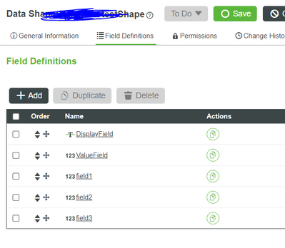

Step 1 : Create a Datashape with the required fields
In my case field1, field2, field3 are JSON keys
Step 2: Create an InfoTable and add a row to it
var jsonValue = {
    "field1": 20,
    "field2": 30,
    "field3": 40
// CreateInfoTableFromDataShape(infoTableName:STRING("InfoTable")
let result = Resources["InfoTableFunctions"].CreateInfoTableFromDataShape({
    infoTableName: "InfoTable",
    dataShapeName: "testShape"
result.AddRow(jsonValue);

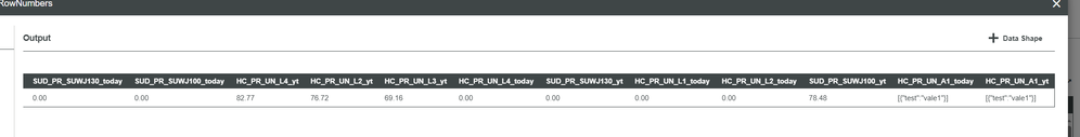

Velkumar
(To:tenegabi)
Hi @tenegabi
Please find below the code and attached datashape for your reference
var jsonValue = {
	"HC_PR_UN_L1_yt": "80.13",
	"HC_PR_UN_L3_today": "0.00",
	"SUD_PR_SUWJ130_today": "0.00",
	"SUD_PR_SUWJ100_today": "0.00",
	"HC_PR_UN_L4_yt": "82.77",
	"HC_PR_UN_L2_yt": "76.72",
	"HC_PR_UN_L3_yt": "69.16",
	"HC_PR_UN_L4_today": "0.00",
	"SUD_PR_SUWJ130_yt": "0.00",
	"HC_PR_UN_L1_today": "0.00",
	"HC_PR_UN_L2_today": "0.00",
	"SUD_PR_SUWJ100_yt": "78.48",
	"HC_PR_UN_A1_yt": [{
		test: "vale1"
	"HC_PR_UN_A1_today": [{
		test: "vale1"
// CreateInfoTableFromDataShape(infoTableName:STRING("InfoTable"), dataShapeName:STRING):INFOTABLE(testDatashape_parsejson)
	dataShapeName: "testDatashape_parsejson"
Output :
Note: Here I have converted JSON Array to String.
/VR

Hello @slangley ,
I made another sollution and it was better for me.
I make an input with name Line, and I write "HC_PR_UN_L1_yt" like a input and it's worked.
I don't use infotable anymore. In the last code as a result I use:
var result = newEntry[Line];
For me it's working.

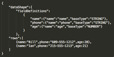

If you want to use,
 var infotableData = Resources["InfoTableFunctions"].FromJSON(jsonData);
Make sure the jsonData is in correct infotable JSON array format e.g. it has rows key with array of data meant to be the infotable rows and the data shape info as object.
(Source: PTC)
You can use this with an actual datashape fields or even without one. just make sure the json is in this format.
Already try this solution, but in the Output the infotable write has no data.
