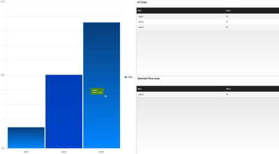

Dear All,
I am using thingworx 8.3 to build my thingworx application, I recently upgraded to thingworx 8.5.4. Everything works correctly except for the label chart widget.
Attach label chart picture before and after upgrade.
Now I cannot select the data when I click on the bar chart.
I don't know why this is happening.
Can anybody help me answer this question?
Thanks and Best Regards.
NBHD.

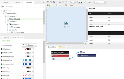

Styling was changed in 8.5, maybe is an issue with styling?
If not, could you upload export of entities to test in 8.5?
Thank you,
Raluca Edu
NBHD207
(To:raluca_edu)
Hi Raluca Edu,
Thanks for your reply
I created a test mashup, with a table data created from the service. I use the label chart to display the data in the table, and the results are similar. I can only select row data when I click on the bar chart border. It is not the same as the Thingworx 8.3 . I don't know if this is a bug or just a new chart design on thingworx 8.5.
Please check the attached file.
NBHD.
The chart is showing like this in my 8.5.4, I just imported it , did not change anything and I can select bar by clicking on the blue area.
Please check the Style Properties on your end, maybe there is something changed.
Hope it helps,
Raluca Edu
